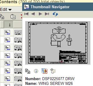

Hi all
Few days ago during customization some configuration was changed(Unintentionally by the configuration guy)
Result-Drawing showing preview of Part in Windchill
The old data was correctly showing but newly published data showed the change
I am showing the preview before and after

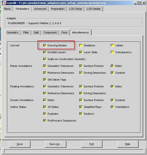

When we contacted the PTC person they gave us the following solution
The setting was changed in recipe option
We just needed to remove the tick and it solved our problem
Later we just republished the data to get the requied result
I am sharing this with the members; so that anyone facing similar problem would know where is the root cause
