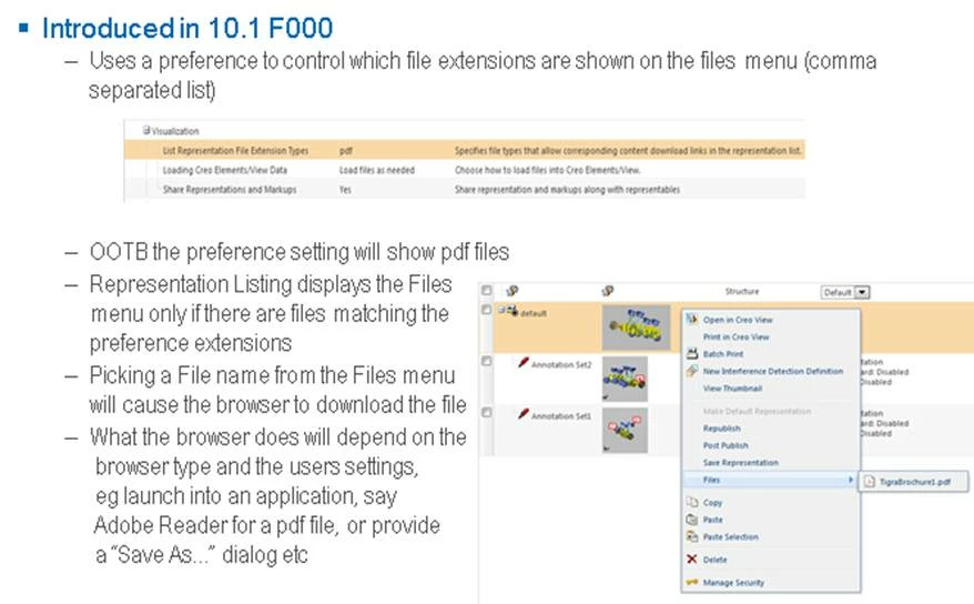

Just an FYI, not sure if it pertains to this conversation but 10.1 allows you to download the PDF directly from the right click button on a representation.
[cid:image001.gif@01CD4AC6.FFABC680]
Steve Vinyard
Application Engineer

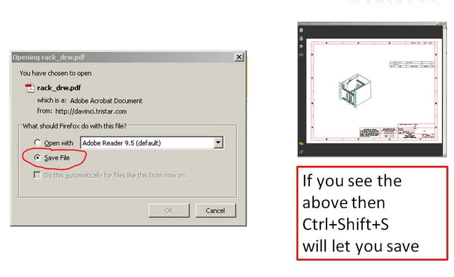

As Steve V pointed out, you can do this even more directly in 10.1 now:
[cid:image001.jpg@01CD4AD8.4123A9A0]
[cid:image002.jpg@01CD4AD8.4123A9A0]
