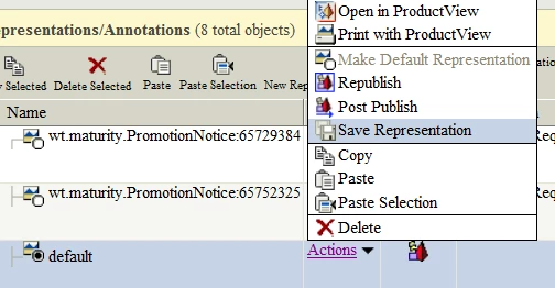

I have my drawings being published as a PDF by my Pro/e CAD worker. This is fine but in the end my users really need to be able to quickly download or email the PDF. Currently the only way to get the PDF out is to do the following:
1- Go to Drawing Details Page
2- Select "Display Representations List"
3- Click Actions>Save Representation

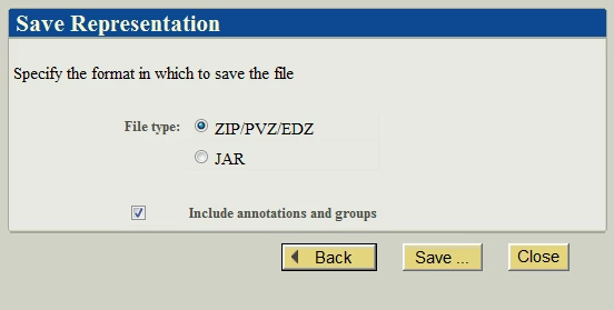

4- Save Representation out as .zip file to desktop
5- Extract PDF from .zip file and email etc

It does not convert on the fly. The new function allows you to RMB on
the representation in the reps table (not the thumbnail), and download
the rep. It creates a zip or a rar (your choice) of the rep and the
thumbnail.

This has been in Windchill for years right?? Or is it different now??
If you publish your drawings as a PDF you can simply download the rep .zip and then extract it out of that.
