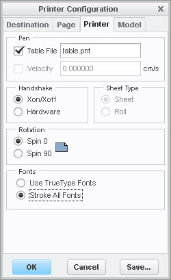

Oct 14, 2015 2:01 PM UTC
Is this a "stroke all fonts" issue as far as text output style?
Hopefully just a side note but I would be way more concerned with the tolerance difference in the Ø80 dimension.
tleati12-AmethystAuthor
Oct 14, 2015 2:15 PM UTC
Hi Stephen,
what are you relating to with the "stroke all fonts" and how can I fix it?
I thank you for your help on the tolerance too, indeed it is an internal technical choice (and that range has not been chosen by me and I also think it is too strict by the way).
bye bye
StephenW
Oct 14, 2015 2:27 PM UTC
Stroke all fonts is a printer configuration setting that converts text to "lines" (for lack of a better word). In my opinion it provides a more consistent output with respect to what is displayed on-screen. I usually add it to the printer configuration file (.pcf). I'm not sure how that works with Creo view and windchill  but if you are manually creating your .plt files, I believe this will improve your consistency.
On the side note of the tolerance, I was referring to the fact that the tolerance was different from your Creo drawing to your .plt output...+.06/+.01 versus +.01. It may be just a simple screen grab at different times in the design/drafting process.
