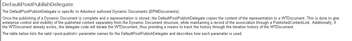

Interesting...is there way to create the PDF(via publishing) as a separate wtdocument/attachment to drwinstead of accessing it through the representation?
November 13, 2013
Using PostPublishDelegate it is possible to store representation as WTDocument. Refer below link of windchill help center for more detail
http://www.ptc.com/cs/help/windchill_hc/wc102_hc/index.jspx?id=WVSVisualizationUsePublishRule&action=show
Hope this helps !!!

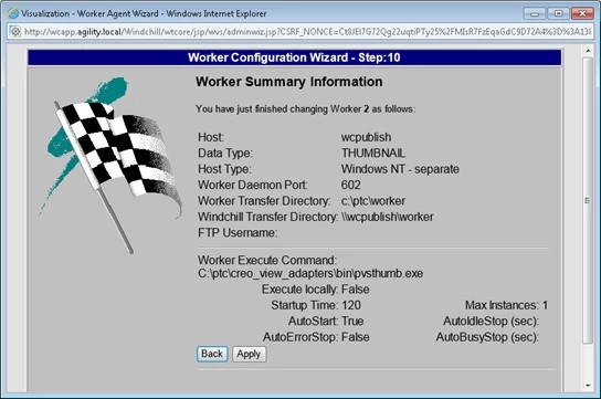

I made an attempt at creating the thumbnail worker. didnt work.I read where you have to configure 1st:
C:\ptc\creo_view_adapters\bin\pvsthumb_config.exe
No luck there.
I have attached an image of my cad worker settings. Please view & see if it needs correction & if all is good there, what night I be missing.
Larry Jett

To create your THUMBNAIL worker, you go to Windchill in your web browser & Select “Site” & “Utilities”. Select “Worker Agent Administration”.
Select the “Configure” link.
From the Window that appears, select “Add Worker”:
Select “THUMBNAIL” worker drop down options & “Next”:
Select “A different Windows NT machine” & “Next”.
In the “Execute command” text area, enter the previously created bat & path: “C:\pvsthumb_setup\pvsthumbworker.bat”.
Set any other options as shown below. Then Select “Next”.
Then enter “601” in the “Port Number” text area & select “Next”.
Enter “\\\worker” for “Windchill Machine Path” & “c:\ptc\worker” for “” “Path (Worker):”.
These are the same as your ProE Worker settings. Or you can select your own, I think. Then Select “Next”.
Verify Your Settings & Select “Apply”.
Selecting “Apply” should take you back to the “Worker Agent Administration” Window. If not, go there from “Site” & “Utilities”.
Your THUMBNAIL Worker should show. It or Both Workers might not have “Status” On. Just as you would start you PROE Worker, Either select “Start all” to catch both, or select the Non On Worker(s). Any Green Flag warrants a Start. Mouse over Flags to view what they stop/start.
