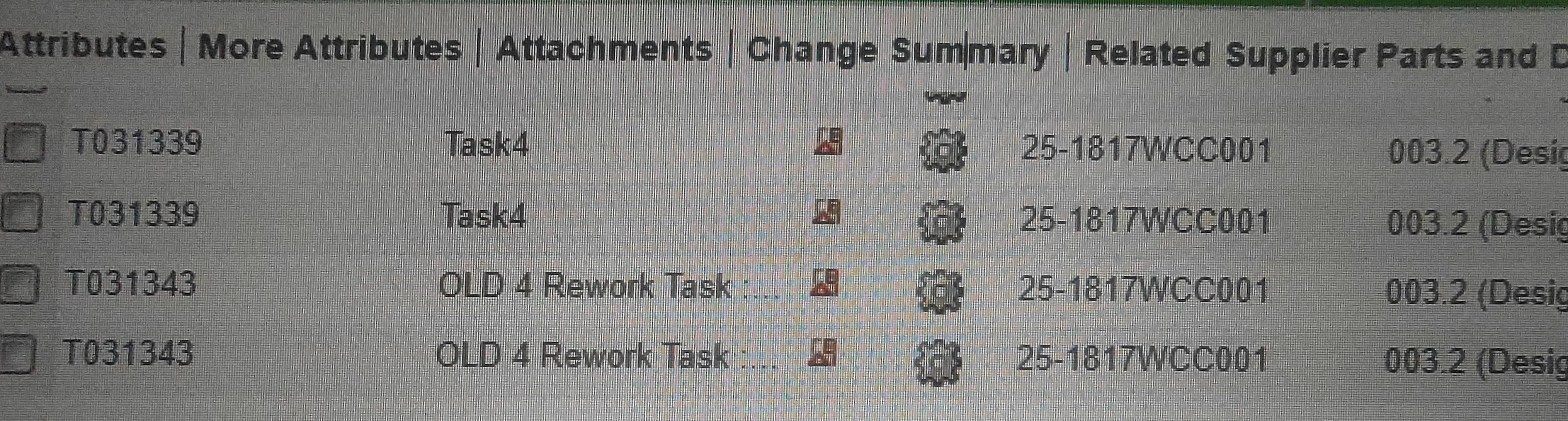

Aug 8, 2024 1:47 PM UTC
Please refer attached snap of CN summary where part *001 with same version added in table for 2 different tasks as an affected and resulting objects.
And we want distinct data in a table.
Aug 9, 2024 5:01 AM UTC
Thanks.
What I think is that your CN Template's Change Task is redundant as you have customized for the Rework Scenario.
I think, when Rework scenario is there, you need to delete the Change Task. Please check this Manually.
Basically, you recreate the issue, but during that delete the Change Task.
I think duplicate entries are due to Change Task .
Let us know.
