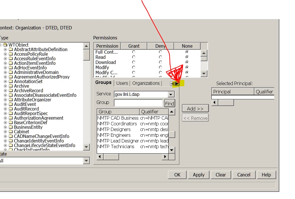

Problem is I don't see a Roles tab. Just have Groups, Users, & Organizations. ????????????? All the roles show a context of Site. So shouldn't I see them?

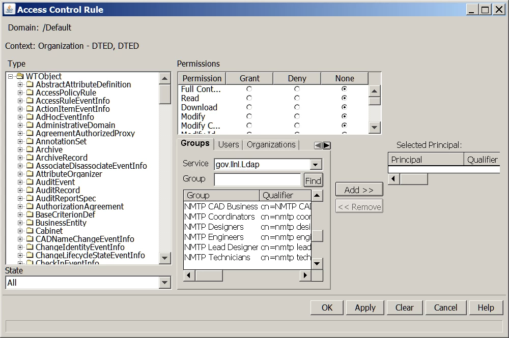

Thanks to Steve for the obvious answer, just make the window larger so you can see the other tab.

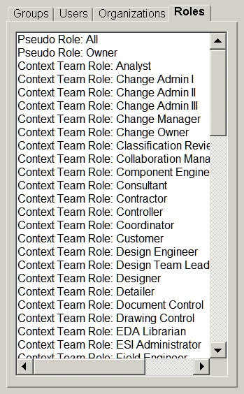

When you are defining an access control rule, the Roles tab doesn't show all the roles in the system.
[cid:image002.png@01CDDE97.F9F9AD50]
I'm missing these roles in the list.
I'm missing these:
Product Manager
Project Manager
Engineer
Lead Designer
Lead Designer is a custom role. My other custom roles show up.

Well actually I understand how to manipulate it now. It's just that the user interface is non-intuitive.
What you need to do is go to the Roles Tab, and change the visibility of the roles you want to see in the Access Control Rule window.
Problem is the user interface isn't logical.
[cid:image006.png@01CDDE99.1379E2D0]This doesn't show up in the list
[cid:image012.png@01CDDE9C.CA1BB3D0]This does shows up in the list
The eyball icon, is not the status, it's actually showing what it's going to do if you click on it. I wouldn't have guessed that, and there is no name on the column to let you know what it is.
The next column with Hide & Show in it, is the status. But as I pointed out to PTC those are verbs, and thus should naturally be an action to take. I believe that should say Hidden & Shown, indicating a state. Verbs = Actions. I forget what grade I learned that in, but it was pretty darn early.
