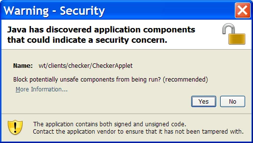

How do I eliminate this warning? "Java has discovered application components that could indicate a security concern." Blah, blah, blah..... (used to have to answer yes, now it's no)
If possible, it would be nice to only eliminate it for our PDMLink production, QA, and Dev sites.

There are generic patches available to address this issue, which was
introduced by Java 6 Update 19.
No, I don't know the patch #, etc, but technical support should be able
to direct you.

Control Panel>Java>Advanced>Miscellaneous (flip the switch on the Mixed Mode Authentication to the one in the middle...I don't remember exactly the name)

Yes, that solves it on the client side, but one can apply a patch to the
server so that no user ever has to do this.
