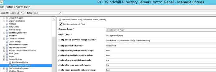

Windchill DS default password policy預設演算法為Salted SHA-1(ds-cfg-default-password-storage-scheme),若要變更其他加密演算法(如Salted SHA-256),對於系統目前的user會有何影響? 原廠是否支援在有使用者及資料的情況下,中途變更Windchill DS加密演算法?

Can you describe the current configuration of your Windchill DS password policy? Are you currently using the default Salted SHA-1 encryption algorithm?
Yes, the current configuration uses the default password policy of Windchill DS, and it is set to use the default Salted SHA-1 encryption algorithm.
Are you concerned that changing the encryption algorithm to Salted SHA-256 might affect existing users and their data? If so, what specific impacts are you worried about?
I’m concerned that it might cause user password verification failures or require users to reset their passwords.

Translation did not work so ran through Google: The default password policy of Windchill DS uses Salted SHA-1 (ds-cfg-default-password-storage-scheme). If I want to change to another encryption algorithm (such as Salted SHA-256), what will be the impact on the current users of the system? Does the manufacturer support changing the Windchill DS encryption algorithm midway when there are users and data?
I would think that this would not matter but certainly worth a test. I found this write up the has a lot of good information: https://backstage.forgerock.com/docs/ds/8/use-cases/change-password-storage.html
OpenDJ is the tool behind WindchillDS.
