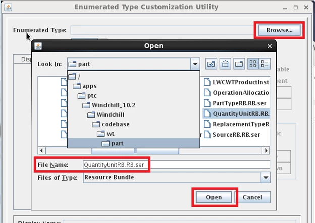

When upgrading, I got an error because I have not yet moved over the custom units, roles, and states to the target 10.2 system. But now in doing research, I see CS111318 which describes to simply use the enumCustomize utility. This seems a lot easier. I also tested it and saw I didn't have to restart Windchill or clear the Tomcat cache or anything. Changes made with enumCustomize seemed to take effect right away.

I normaly use enumcustomize for adding/hidding some values to the different languages. Enumcustomizing saves these changes to the WTCustom folder and compiles the files.
If you already have all the changes in the WTCustom folder you have to save each file to have a new modification date and afterwards you can compile these changes without opening every file in enumcustomizing.
