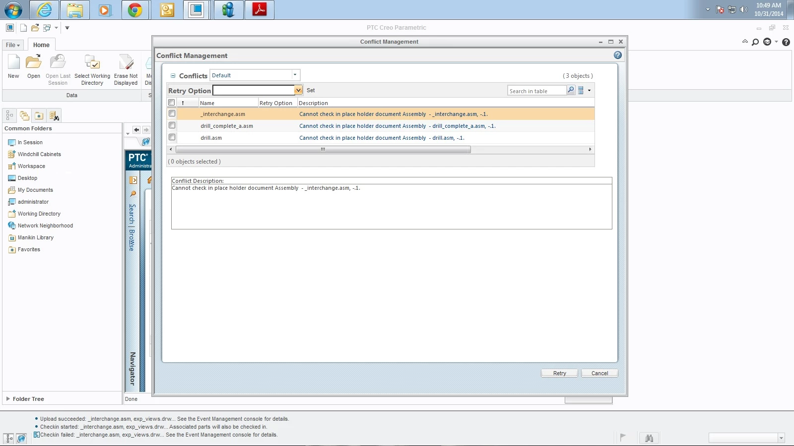

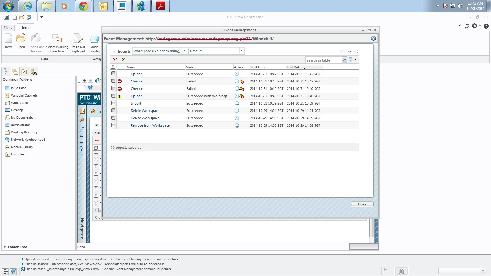

I import cad files on my windchill using creo. The importing was successfull but when I'm going to checkin all. I got an error. Can you help me how to resolve this error?.,
Thanks!

Please try taking a look at the following article. It sounds like you have some ghost objects in your workspace that is causing these errors:
http://support.ptc.com/appserver/cs/view/solution.jsp?n=CS20956
