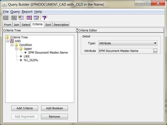

Hi Jane,
I appreciate you looking into this with the developer. I've tried
using the escape characters you've mentioned but they don't appear to be
working in query builder. In the example screenshot, I'm trying to find
all EPMDocuments that have "_OLD" in the name. This query returns 0
results when I use the \ or [] characters. If I don't use the escape
characters, the query treats the underscore as a wildcard.
I can run the following SQL query outside of query builder and get the
data but i would like this report to be available for non-admins.
select NAME from epmdocumentmaster where UPPER(name) like '%\_OLD%'
escape '\';
Thank you for your time,
Dax
