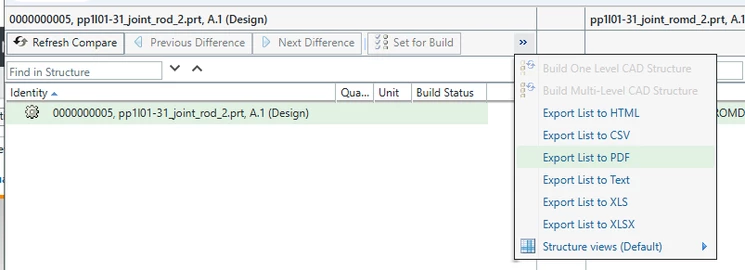

Does anyone know if the export menus can be added to the CAD to Part Compare?
HelesicPetr
Apr 30, 2025 6:38 AM UTC
Hi @MM_10260548
You can try to add the export menu to the comparation menu.
just change a customActionModel.xml file . You have to find correct element to change and add a row for the export menu

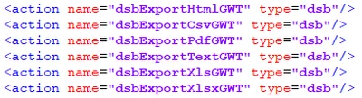

just add the following rows
xml file is located in codebase\config\actions\customActionModel.xml
<?xml version="1.0" encoding="UTF-8"?>
<!DOCTYPE actionmodels SYSTEM "customActionmodels.dtd">
<actionmodels>
 <model name="dsvp2cPartTreeToolBar">
 <action name="resetCompare" type="dsv"/>
 <action name="prevDifference" type="dsb" />
 <action name="nextDifference" type="dsb" />
 <action name="separator" type="separator"/>
 <action name="publishToCADGWT" type="cat"/>
 <action name="buildCad" type="dsv"/>
 <action name="buildCadAndDesc" type="dsv"/>
	<action name="dsbExportHtmlGWT" type="dsb"/>
	<action name="dsbExportCsvGWT" type="dsb"/>
	<action name="dsbExportPdfGWT" type="dsb"/>
	<action name="dsbExportTextGWT" type="dsb"/>
	<action name="dsbExportXlsGWT" type="dsb"/>
	<action name="dsbExportXlsxGWT" type="dsb"/>
 </model>
</actionmodels>
Results
PS: it is not ideal, it can throw some errors if the wtpart does not have linked cad but it works.

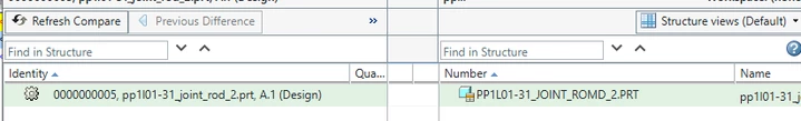

Apr 30, 2025 1:20 PM UTC
@HelesicPetr, will this work on the Part2Part compare also or do I need to look for another model in place of
HelesicPetr

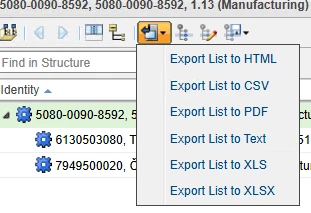

May 5, 2025 5:32 AM UTC
Hi @BrianToussaint
Actually I took the model(export function) from the PartToPart comparation wizard 😄
