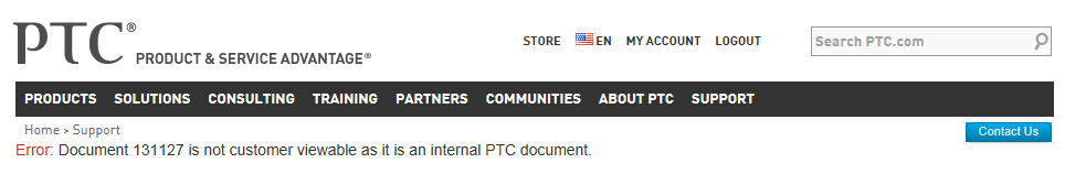

I'm getting an error here.
Error: Document 131127 is not customer viewable as it is an internal PTC document.
