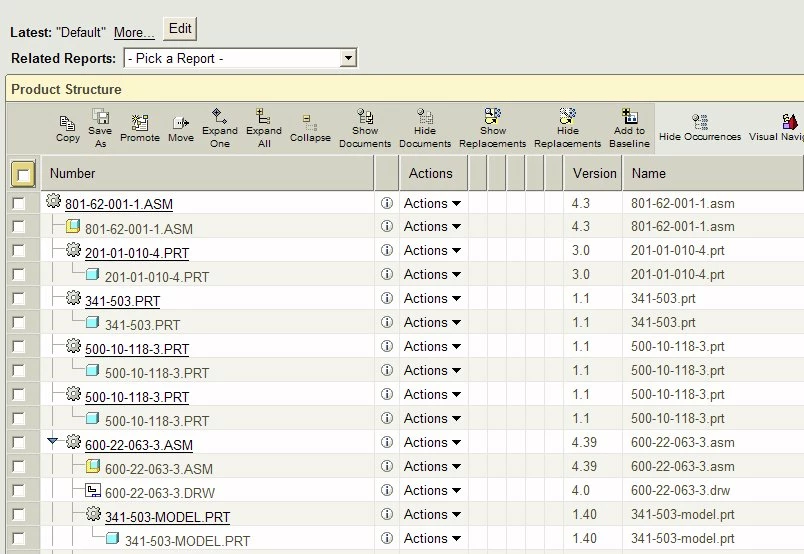

We have recently migrated from Intralink 3.4 to PDMLink 9.1 and I am looking for a wayof identifying ProE Models with associated ProE drawings. So far I have found a way to display this information within PDMLink by searching for the top level assy WTPart and showing the structure, then expanding and using 'Show documents'. What I cannot do is export a snapshot of this structure with all the associated ProE documentsincluded (see attached screen shot). Does anyone know if this is possible, and if so how is it achieved? Possibly it requires a script? Any advice gratefully received. Chris Glenister, Thermo Fisher Scientific, UK.

The easiest way to accomplish this is to write a report in the report manager using the Query Builder. You should be able to get all the info you need in a report.

Don't know of any way to export as you say - hopefully others will answer.
Seeing the screen capture though, I'm curious why you have the same information in both Number and Name. Ideally the Name would be words that are helpful (e.g. bracket, module 23F, etc.).

You could add the toolbar to that table that gives you the actions/menu for
export to excel. Never tried it. Best guess also is if you run the report,
might be a way to export.

Iforwarded the presentation of the download WTPart/EPM Structure which is what Najanaja.comprovidedfufilling my architecture design. With every download of WTPart, you'll get a tsv report at the level requested. You can do the view report first then export to TSV (tab dilimited in case of commas in the name) which will not get any associated documents, or you can just download the entire package based on various baselines. More advanced baselines are in the ECN reports during review. See attached.
