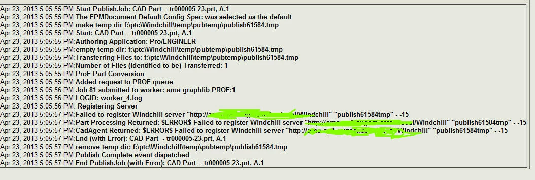

This error message just started to happen with a few users over the last week or so. Most users drawing and parts when going thru the publisher are going with out any problems. I tried the solution in TAN 146494 and had no luck.
Windchill 9.0 M060
TIA

I found the issue. The cadworker machine cache must of been hosed up. I deleted the .wf folder on the cadworker machine, stopped and started the worker and everything seems to be working.
