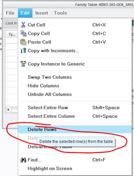

Is there a way to prevent Windchill from accepting a check-in if the list of instances in the Generic being checked in does not include all the instances that were in the latest version?
Is there a way to generate a message to the Admin when a check-in or check-in attempt of the Generic list of instances is missing instances there were in the latest version?
12 replies
May 9, 2016 2:50 PM UTC
You are getting the same response I usually get when looking for solutions with Family Tables...crickets.   Keep in mind there is a contingent out there that wants to be able to modify certain instances without touching the generic or other instances even though PTC's recommended practice is to treat the entire table as one when checking in.  You would think it would be pretty easy for PTC to create a config option that hides the delete option in the menu of Creo parametric for family table rows. This is the source of the problem where the issue could be mitigated if removed.

I looked at Marco's list and it looks like the tools are there to manage the task, so I am not understanding why they aren't used.
Getting rid of Delete would help, but there are still users who type new names over existing names, which produces the same result. There is also the case where clever tykes will create an entirely different table outside of WC and import a Generic using that, stomping the existing table or just a plain item with the same name wiping it all out.
