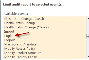

This info is available here (pulls from auditrecord table):
[cid:image005.png@01CF270A.38AE58A0]
[cid:image006.png@01CF270A.38AE58A0]
Provided configAudit.xml is configured (as it is OTB) with “login” - true

Thank you for your suggestions. Your suggestions helped me to fetch needed report from the database.

That query appears to find all logins for all users during the time
specified. In my case, to search over the last 90 days the report was 20k+
events. Is there a way to reduce it to remove duplicates?

Probably this UI cannot - it runs a query without "latest" (SQL maximum). Not well-structured or scalable.
Likely have to use the direct database query suggested by others - or similar in a query builder report also suggested by others. We use a direct database query.
