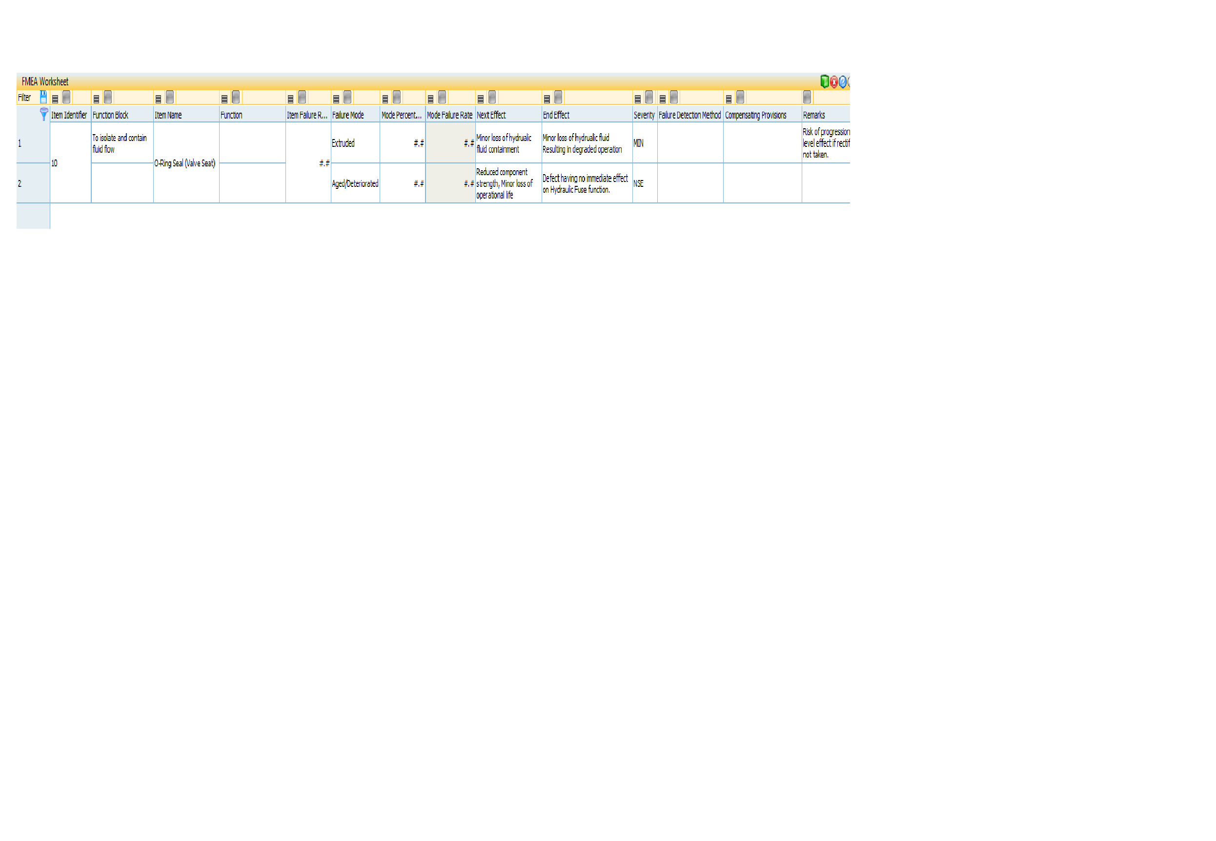

Kallum, could you be a little more specific? You refer to adding a new mode, but wish to not add another line/row. Could you provide an example?
September 30, 2014
Hi thank you for the reply
i have attached the following screen shot as a example. as you can see some colums are merged through the rows while others are not in particalur column 1 and 2. how can i get colunm 2 to appear the same as column 1
September 30, 2014
I would check your FMEA Data Structure. Currently our FMEAs are set up as you have desired and the structure is "Standard FMEA".
