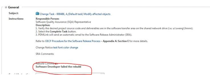

Dear Experts,
I had a request to modify the color of the text for a variable in for a workflow activity.
Here is what I added in the activity tab for the assigned activity:
{rebuildStatus}
It displays as red in the email, but not in the browser:
[cid:image001.jpg@01CF7120.B7A1A530]

Ray,
You have to enclose the string with a for it to show up in both the browser and email correctly.

Mike,
Thanks! All set.

May 20, 2014
Span works great for the font but what about other tags?We had quite a bit of formatting done to our workflow activities (font color, ordered list, unordered list, div, etc.) which looked great in Windchill 9.1. Now we're on 10.1, I can get the emails to look great but the task loses nearly everything. I've searched tech support and haven't found a good answer. I was about to open a ticket but saw this post. Any thoughts?

Please set the property value wt.workflow.worklist.escapeHtml in
wt.properties.
it has two values scriptonly and allhtml
You can find more information from codebase/properties.html file
