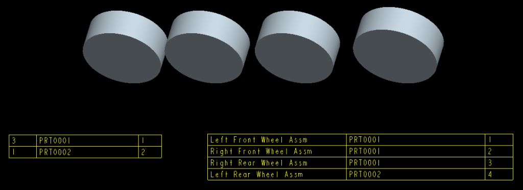

Is it possible to create a functional description of a part or assembly in a model that is carried through to a multi-level BOM that can be exported to an Excel file?
For example; I want to functionally identify a "Right Front Wheel Assembly" as being different from a "Left Rear Wheel Assembly" but they have the same part number.

If one designs a vehicle that has three wheels the same and one odd one (hypothetical case, because I would not design such a vehicle) it would be nice to be able to automatically extract from the ProE model information as in the “table” below:-
Functional Description Part Name Part Number Quantity
Right Front wheel 15” Wheel Assy WHL15-230 1
Left Front Wheel 15” Wheel Assy WHL15-230 1
Right Rear Wheel 15” Wheel Assy WHL15-230 1
Left Rear Wheel 14” Wheel Assy WHL14-210 1
As far as I have been able to establish from the clever ones (I am not one of those – I aspire to automating the project management process based on the modelled products) in our organisation, ProE will automatically change the contents of the “Functional Description” column to the last entry made in such a column for all the components that have the same Part Number and one ends up with following fairly useless information:-

Try adding the Functional Description description as a flexible parameter and see if that gives you what you want. This will allow you to create two tables one for purchasing group and one for the assembly group. Here is an illustration of what you would get:
The tables are sorted by the information that is important to the groups. I believe you can export the BOM tables with the same formating shown although I'm not as familiar with how it works. Here is an additional picture illustrating what you would have in an assembly. Although parts are shown the same can be done for assemblies.
