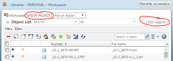

It's hard coded that admin has access to see / delete other user's workspaces but can't see inside them.  An additional query builder report can easily be implemented to list the contents of individual workspaces - we have that in place.

Mike Lockwood‌, something has changed.  I just noticed yesterday (by accident) that I can now see the entire contents of other user's workspaces (everything uploaded.)  The trick seems to be finding an object that is in one of their workspaces, viewing that object, and then following the bread crumb link back to their workspace itself.  I'm betting if I followed the step in CS199288, I could probably browse directly into any of them without first needing to find an object in each workspace.
Just to prove that this is not one of my workspaces.  I don't even have any workspaces in this context.
By the way, this is with 10.2 M030 CPS18.

Thanks Tom - great to know. We will likely implement the property change to take advantage of this.
