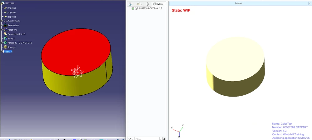

Our designers assign colours to their models in Catia to make orientation easier in Catia as well as Creo View.
Sadly, the colours do not get through to Creo View representations although "Use Face colours" is ticked in the corresponding rcp file.
Can someone advise, please?
Here are the errors that I faced
No error message, worker doesn't throw any error it just ignores the colours

    Can you share Catia view vs Creo View view? What color is it choosing in Creo view?

    thanks for responding and for the link. I found a similar article recommending ticking the "Face colors" in the rcp file, but that didn't make any difference.
    I am not Catia person, but I managed to create a simple cylinder and assign colour to every "face" (the bottom, invisible one, is blue).
    I noticed there are options to assign colours on many levels, and I tried assign different colour on each of them, but the colour you can see on the righthand side in the Creo View was not among them.
    We actually need to make this "colour coding" working for Creo and NX too, I just started with Catia as I am expecting it to be the most difficult one. 🙂
    Color testColor test
    I am trying to apply the fix from the article you sent and will report back.

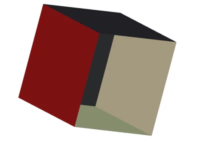

    ok, I made my own test as well.
    and here is how it appeared in Creo view.
    Now these were material appearences, one with transparency. Seems like differences I am seeing is in lighting but I would say that it respected my intentions. There is a lighting option in Creo View.

    The two settings I can see as influencing it are "Render Faces As" which I have as default and Texture Maps as Convert
