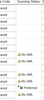

4. Let's knock this one out quickly. Short answer is No which is what I expected. Sourcing status is blank for Make parts. I can work with that. It would likely be more confusing with No AML showing for all Make parts.

Now what about a pure vendor part like McMaster Carr. They like Digikey create their own part numbers. So they may exist in our BOMs already as regular Parts. It would follow I should create a Vendor part of the same number tied to Vendor who owns the part number. But wait, this leaves a gap in AML only creating an AVL.  I can confirm that you do not see a sourcing status value ( shows no AML ) when you only have vendor parts linked. Its true and PTC says by design.  Perhaps I just leave it as is. I will never care what the status is when selecting parts from the library of a vendor part. I cannot see them ever being preferred. And we lack the original MFG source in a form that can be loaded easily.  Moving on to last question.
