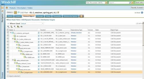

Dear PDMLink/Windchill experts,
We have a requirement to generate a report with the following criteria.
We need a different kind of Windchill extract. A "Where Used"
What we want is a listing of every .prt file with every .asm that it is a member of.
Then a listing of every .asm and every .asm that it is a member of
We are not looking for drawings, just prt and asm files.
Below are the headers for the report.
Name, Number, Description, Revision, State, Context, Location, Last Modified by, Last Modified on
regards

Hi Venkata
this is a screen shot from R10.1 M030 (OOTB Demo data) that shows
multi-level where used report.
By customizing the table, different columns can be added. Is this is the
kind of report you are looking for?
Thank you and have a great time.

Hi Senthil,
Thanks for your response.
The Screen shot below is good for a part/asm.
The Report we are looking for all parts/asms..not for single part/asm.
Obviously we need backend(oracle/sql) report but not through UI I think.
regards
