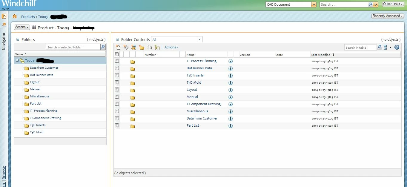

I'm working on Windchill 10.1 M030 PDM Essentials instance.
My requirement is I have Multiple Folder structure into my Folders in the product and I want my viewer group to see only particular folder and sub folders that are available from the entire list. (refere my attachment where you would be able to see 10 Folders and I want my people in the user group to see only some 2 folders).

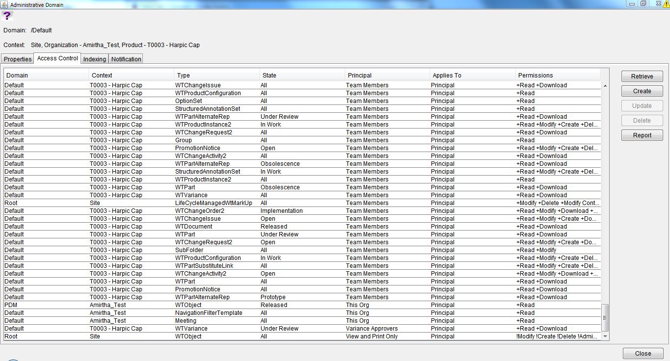

What I had been trying to do is:
> I tried creating a new policy rule for Folders in the specific product context and set it to Deny for the Viewer group - But after doing so even if I allot Read permission in the security access of the specific by doing "Right Click - Manage Security" for the specific group/a user - It didn't work.
Can someone suggest me what is the best way to do this?
