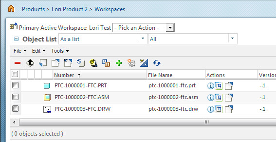

What is the correct procedure for duplicating assemblies and drawings in PDM Essentials?
- I tried save as, but it does not work because it wants me to rename sub-assemblies and I don't want to do this.
- I tried renaming, but because they are not new items in workspace, it doesn't work either.
I just want a new assembly name and a new drawing name so I can check them in as new items.
Best answer by LoriSood
Benito,
I got a hold of a PDM Essentials server and this is what I did.
I have the following files:
I select both the drawing and assembly in my workspace and select File > Save As:
In the Save As window I can do either: Change Dependents to None:
Or select the dependent part and click the exclude button:
I don't know how you're doing it, but this is what worked for me.
The copied drw/asm refer to the original part.
Also see the attached video

Benito,
Forgive me, but I don't have PDM Essentials installed on my system so I haven't tested this out. I did take a look at how PDMLink, though, and I imagine that it should be similar.
Do you not have the ability to exclude dependents from the Save As?
Or change the Dependents from Required/All to None?
September 8, 2014
Lori:
Thank you for your reply.
I am not sure what those options do but I did not see them available from my workspace.
Maybe I should explain further to make it easier.
I pulled one of many drawings that are related to an assembly file by adding it to my workspace (not checked-out).
- This means this drawing does not have the same name as the assembly.
- But it is a good starting point so I don't have to recreate the entire drawing.
I then opend the assembly model and added more components to it and added more x-sections.
Now, I want to keep the association between the drawing and the assembly, but with new names for both.
I only want to put a new name for the drawing and a new name for the new main assembly.
I want to reuse all of the components and not re-name any of the parts or sub-assemblies in the process.
Is there away to do this so I can check-in both files?
TYIA
~Benito

Benito,

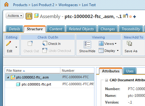

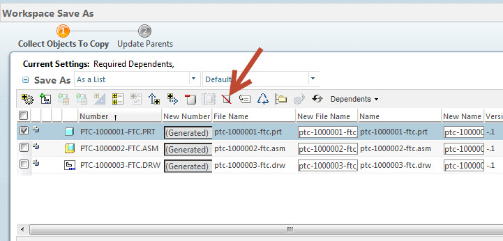

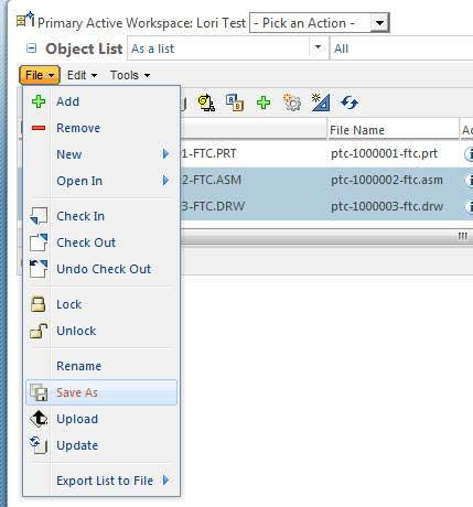

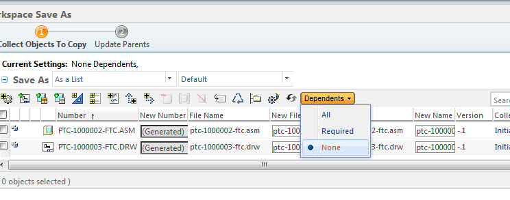

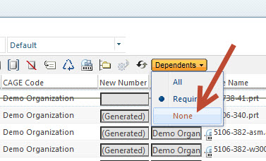

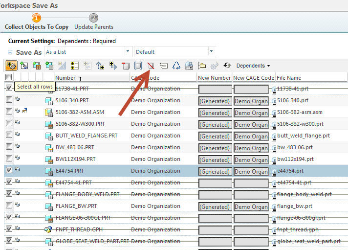

September 8, 2014
Thank you very much Lori.
I found out my problem had to do with not updating my updates to the server first.
Once this is done, I was able to do a save-as without any problems following your process.
~Benito.
