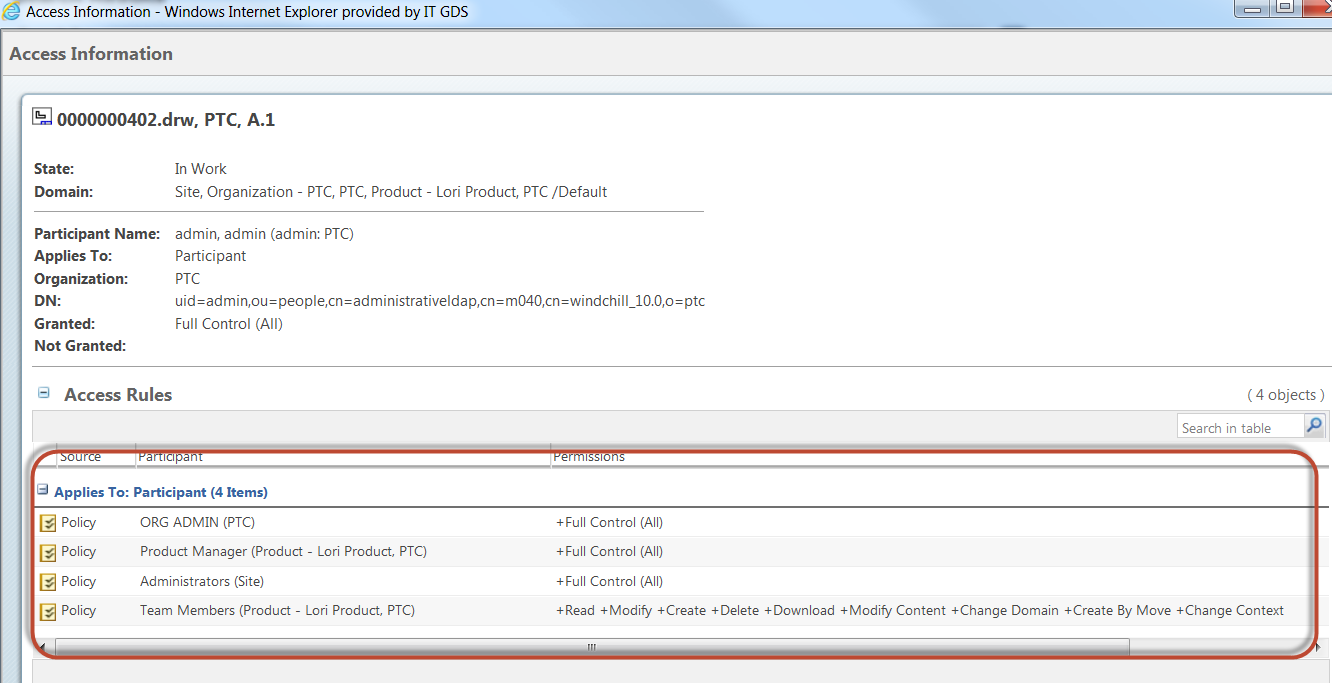

You can check the Access Information Table via Manage Security to find out why a group still has access to the objects:
Select Actions > Manage Security
Add the principal to the list via the "+" button
Click on the info icon to open the "Access Information" table
Update the permissions/policies listed accordingly to get the desired level of access.
Refer to Access Information Page topic in the Windchill Help Center for more information
