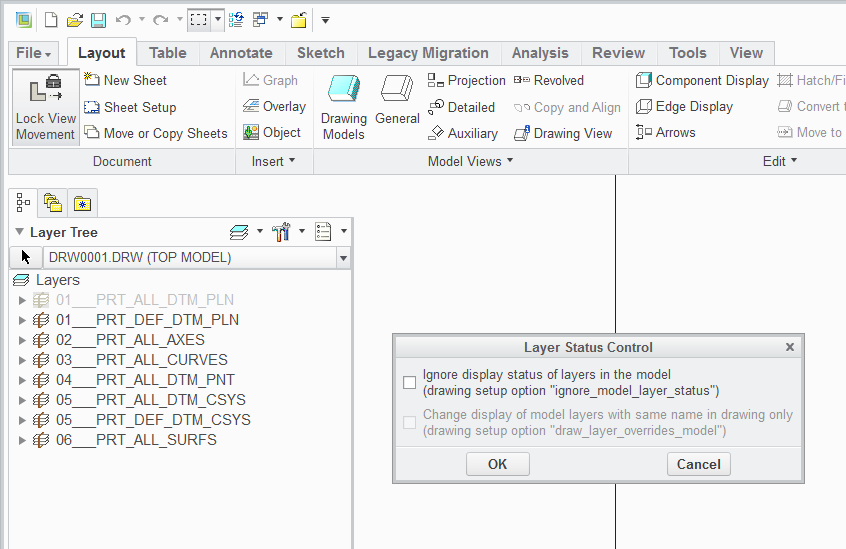

Hi all, we are migrating ours data to Windchill 10 but we notice that are drawings with planes visible, so when WC generates the representations the datum planes are visible and there´s no way to hide it at Creoview.
I ask you if it´s possible use Modelcheck to hide the datums and how I have to configurate it?
Thanks in advance
Renaldo

Hi Renaldo,
if you need set same layer options for your model and drawing - do you need to set the drawing configuration option:
ignore_model_layer_status no
Vladimir
August 3, 2012
Vladimir,

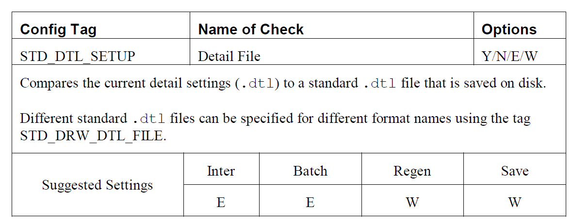

I believe he is wanting to do this using modelcheck or batch modelcheck.
In that case the setting is controlled under draw_layer_overrides_model using the STD_DTL_SETUP in modelcheck.
ingnore_model_layer_status no Using modelcheck to change this setting you must look for draw_layer_overrides_model in the modelcheck settings.
Not sure why PTC is not referring to this setting using the same name in dialog box and in modelcheck.
Hope this helps,
Don
August 3, 2012
Dear Don,
the configuration option ingnore_model_layer_status no you can set for DTL file and it is works perfect in drawing mode (you are true - in session).
If it is work in batch mode, I think that Renaldo need to try
Vladimir
August 6, 2012
Hi Don and Vladimir, I appreciate yours contributions.
In fact, I´m going to configure the modelcheck to work with Windchill 10.
At this moment, the main obective is blank the planes at model and drawning files to avoid them to be included at representation.
I tryed the configurations suggested and I noticed I have to set ignore_model_layer_status and draw_layer_overrides_model as YES to make modelcheck works as I want.
By the way, I didn´t know the command STD_DTL_SETUP to override draw_layer_overrides_model. This will be very useful as you mentioned above because I intend to use batch mode.
Thank you both,
Renaldo
August 7, 2012
Hi Renaldo, You are welcome
Here is some information about STD_DTL_SETUP:
Vladimir
