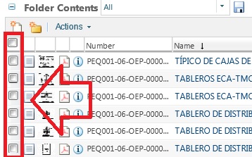

I need add checkbox "select rows" in my customized table:

Best answer by VasiliyRepecki
table.setSelectable(true);
August 19, 2014
August 19, 2014
Thank you Vasiliy,
Besides this, I also added the counter:
table.setShowCount(true);
It was perfect .
Felipe.
