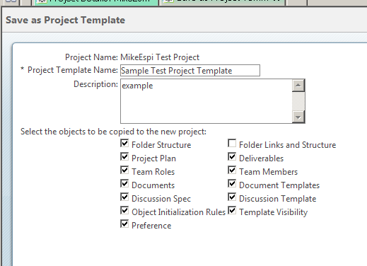

Best answer by MichaelEspinosa
Shweta,
Look into and research creating and using a project template. In a nut shell, you can create a project template from an existing project. The project template is stored at the org level under the templates GUI. This new project template can be used to create all the other projects going forward for your org.
In an existing Project, on the "detail" GUI, select "Save as Project Template". Below is an example of this GUI.
Be sure to select "Team Roles" in this project template. See the Windchill help for a description of usig and creating project templates.
Mike
