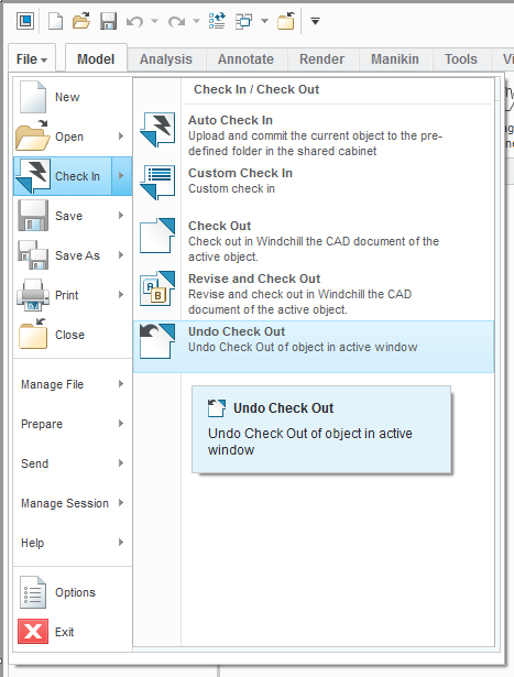

How to cancel the checkout object from creo application ?
Ex:
After i check out i understood that the changes is not necessary ,by the time I want to cancel the checkout process to avoid unnecessary iteration creation .
Best answer by TomU
From Creo directly, 'File', 'Check In', 'Undo Check Out'.
TomU23-Emerald IVAnswer
August 5, 2014
