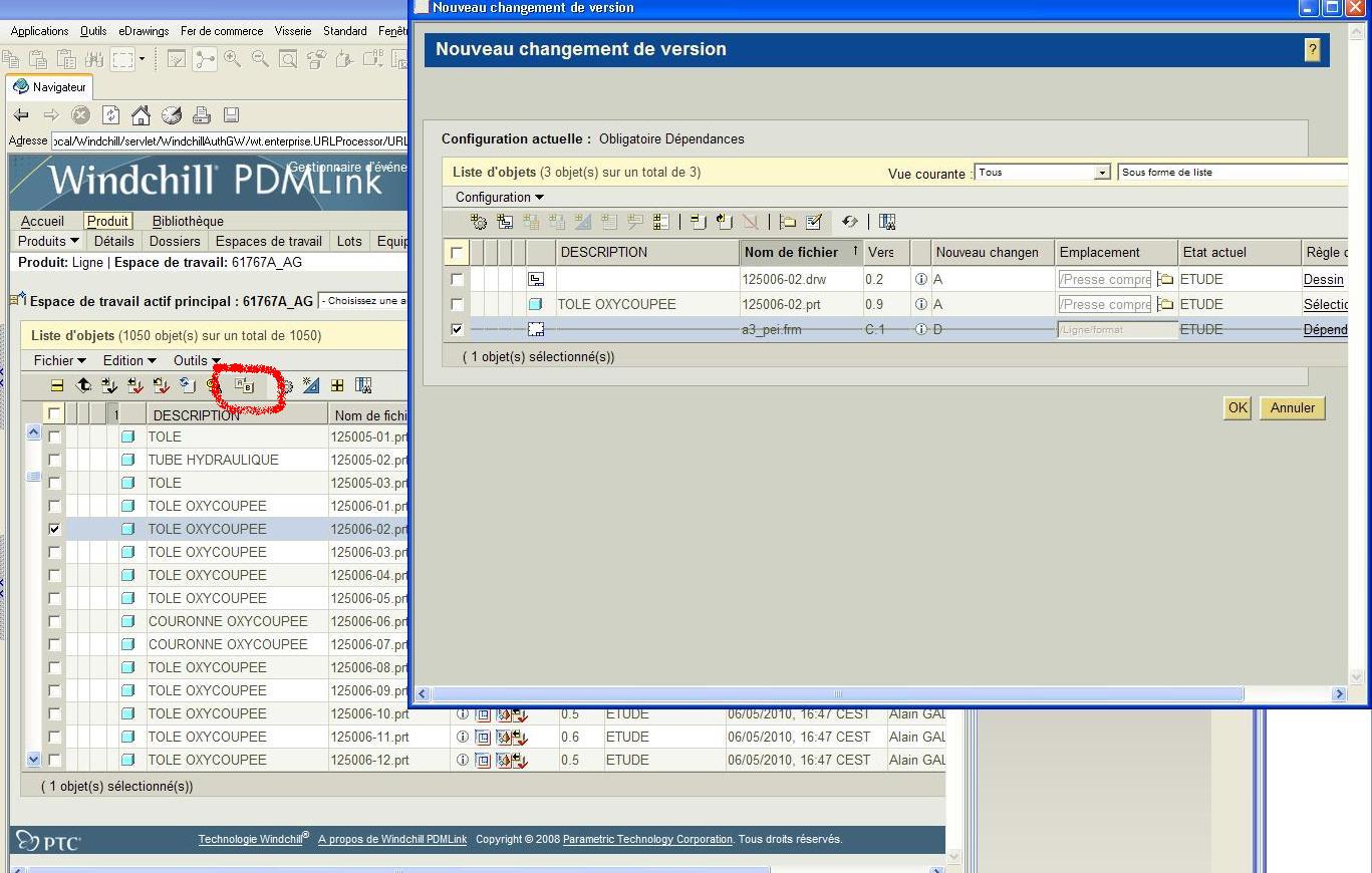

Achille
If I understand your question :
September 24, 2010

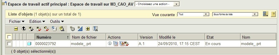

Alain, that's it but I don't see the "revise" icon in my workspace :
Do I need some admin special permission ?
September 28, 2010
Achille!
Yes!
Normally, in a standard business configuration, you only revise objects who are in a released Lifecycle-Status.
So, I'm not shure, if your status (En Cours) is a released one...
Thomas
