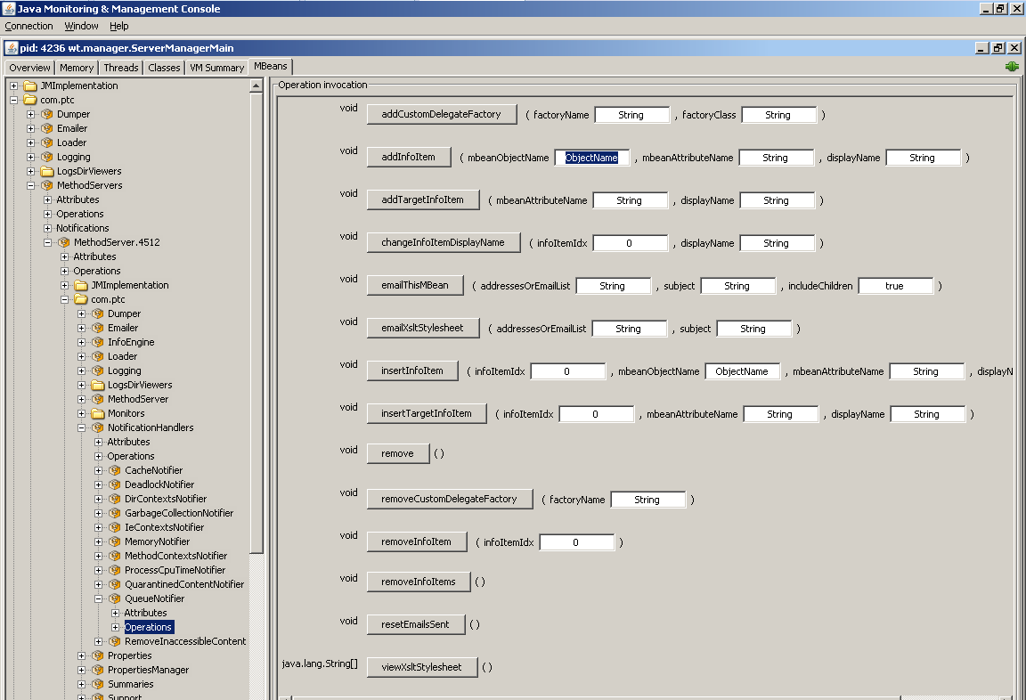

2) Navigate to com.ptc-->MethodServers-->MethodServer:PID-->com.ptc-->NotificationHandlers-->QueueNotifier-->Operations
3) Enter the following arguments to the addInfoItem method.
           mBeanObjectName=com.ptc:wt.subsystem=Dumper
           mBeanAttributeName=FullStackTrace
           displayName=displayName=FullStackTrace
Click the addInfoItem button to add this method. You should see a "Method successfully executed" pop up.

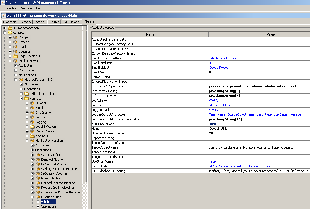

4) Switch to Attributes node for the QueueNotifier, set the attribute MultiLineFormat to true.

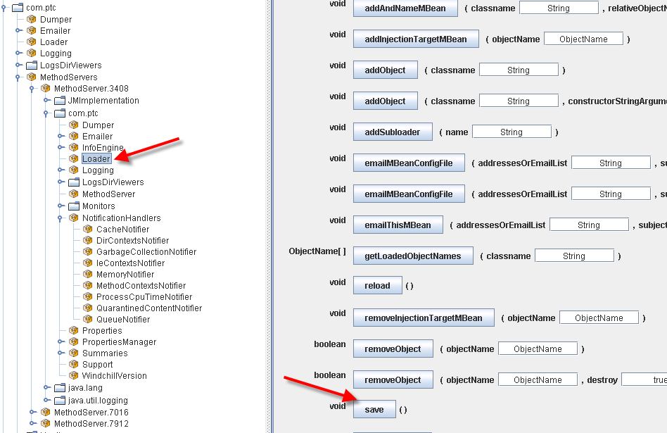

😎 Navigate to com.ptc-->MethodServers-->MethodServer:PID-->com.ptc-->Loader-->Operations
Click the save method to save the changes made to the QueueNotifier and WfUserWorkQueue. You should see a "Method successfully executed" pop up.

To add a particular bean (and capture its current state) it must be injected into the configuration. This is done via the Loader/operations tab (in jconsole) as follows:
start jconsole
navigate to the bean to be modified & change desired attributes
note the full name (path) of the bean
navigate to the loader/operations tab
invoke addInjectionTargetMBean (name-of-desired-bean)
invoke save
By way of example, I modified the minutes between notifications time for the NotificationQueue
Injected it into the configuration:
addInJectionTargetMBean (com.ptc:wt.subsystem=Monitors,wt.monitorType=Queues,Name=NotificationQueue)
And saved the configuration. When I restarted Windchill the minimum notification interval change was restored.
