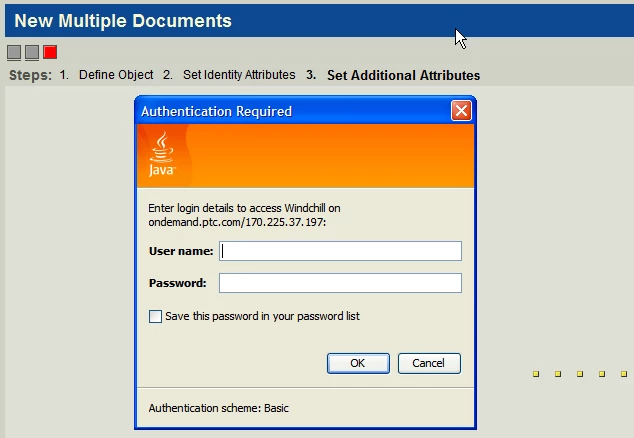

Hey Y'all:
We are currently on Windchill 9.0 m060, and when we use Internet Explorer to access Windchill, whenever a java applet launches, we have to "login" or Authenticate to get the applet to run. I will attach a screenshot showing the login window.
Funny thing is when you do the same thing using FireFox, no authentication window appears. MUCH nicer. Because of that, I don't think it is the server requiring us to authenticate.
So: How to get rid of the authenticate login?
-marc

The server requires the same authentication in either case.
The issue is all around how the browser and Java Plug-In share
credentials so you don't have to re-enter them -- or fails to do so as
the case may be.
In the case of Firefox (on Windows at least), this sharing just plain
works -- as you noted.
In the case of Internet Explorer, this will /not /work /unless/ you
check the "Remember my password" checkbox when logging into Windchill at
the browser level. This is due to an architectural shortcoming in
Internet Explorer according to the various folk I've asked (e.g. Sun
engineers).
I've had reports of cases where Internet Explorer and the Java Plug-In
fail to share the password even when this checkbox has been checked, but
have not managed to reproduce this, much less determine why this ever
occurs or how to fix this. This is a failing in Internet Explorer
and/or the Java Plug-In whose nature I've not been able to discover and
which is quite independent of Windchill as best I can tell.
Where possible the best solution is to simply to use Firefox (which is
faster too).

Jess,
Thanks for the info. We do experience the case where IE and Java fail to share the credentials. If you check the "Remember my password" box on the Java Authentication window, it will only remember it for that session. If you log out and back into Windchill you will have to re-enter the credentials every time.
Most of our users here have, and I do myself, have the Remember my Password checkbox selected on the IE log in window too, which does not help either.
Guess we will need to look at moving over to FF "officially".
-marc

I wish I knew why or how to resolve this case. It could be as simple as
some obscure MSIE setting, but so far no one has figured this out.

If you mean the dreaded double-authentication, then the solution is Java
6 Update 23 -- due one of these weeks...
