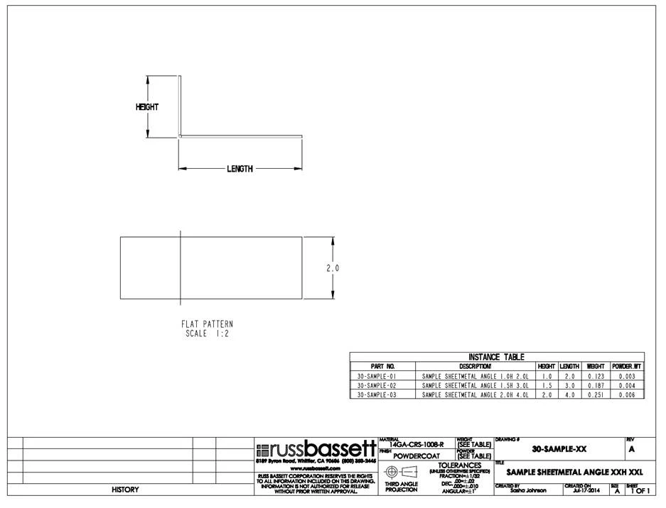

Does anybody have a solution in Windchill for added a family table instance to a generic while still keeping the revision of the generic and all existing instances the same? Currently when we have the need to add an instance it falls on the WC admin to set the state of the generic and all instances from Released to In Work, and then the designer adds the new instance, Checks In, and generates the Promotion Request. Upon approval the generic and all instances are back to Released at the same revision. We are trying to offload this burden from the admin to a standard workflow practice for all designers.
Ordinarily this would involve a Revise, but we cannot burden our CNC programmers here with updating all revisions to existing programs whenever we add an instance (the existing instance geometry is not changing, essentially we are just generating a new object). Further to this logic we want to keep all instances, the generic, and drawing lock-stepped in revision. New instances come in at the latest revision level of the rest of the existing instances, and any global geometry change that affects all or most of the family table instances would then follow the typical Revise workflow, taking all objects up to the next revision letter.

Just to clarify, you have a generic (with many instances) and a drawing linked to it. The drawing shows the revision of the generic model. Both are released. You need to add an instance and when you revise the drawing shows the new revision. This causes issues downstream in production.
July 17, 2014
Correct. The generic (with many instances) and the linked drawing are all released at the same revision. The drawing format shows the revision of the generic. A revise bumps the revision which is not acceptable to production, as it burdens them with revving up all existing programs when in fact their geometries did not change.

Thanks Mike! I was really hopeful of using your second method a couple of months ago, with the added drawing detail of having the title block revision cell show "(SEE TABLE)" exactly like we tabulate our instance weights and powdercoat consumption (see below). To automate the relations would be as follows:
/* RETURNS "SEE TABLE" FOR GENERIC REVISION:
IF REL_MODEL_NAME!="NULL"
pointer=search(REL_MODEL_NAME,"XX")
IF pointer==0
REVISION=PTC_WM_REVISION
ELSE
REVISION="(SEE TABLE)"
ENDIF
ENDIF
Unfortunately Windchill parameters (specifically PTC_WM_REVISION) cannot be using in a family table, so getting that revision data in the 2d repeat region is out.
[cid:image003.jpg@01CFA1A7.4B4DE440]
We are now leaning towards method 1. Our current thought is to give all designers (currently all veteran ProE guys) the ability to SET STATE on objects (non Library only) from RELEASED to IN WORK, but then a promotion required to go back to RELEASED. This would provide a safety net as they would always pipe thru an approver that could reject the promotion if the changes were undesirable.
