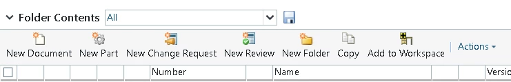

Version: Windchill 13.0
Use Case: I need to change the shortcut buttons in the folders based on organization. How can I manage the FolderManagement-actionModels.xml file based on organizations?
Description:
I have two organizations and I need to manage the folder shortcut buttons in each organization separately. When I modify the FolderManagement-actionModels.xml file it reflect all organizations. How can I separate the xml file organization based?

Hi all.
My question is if you need to just play with the ribbon menu where the actions are as shortcuts or you really need to hide the action from the menu at all.
If you want to just show shortcut actions in the ribbon menu based on organization, it is not possible based on organization.
If you really need to hide the action from the action menu then an own custom filter is the solution.

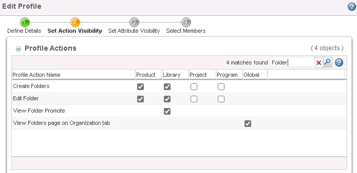

Maybe another option is to use Standard Profiles at the organization level?
I'm not clear if you are trying to hide a PTC action or adding your own.  If adding your own, this help center page shows you how to add your actions to the Standard Profile options.
https://support.ptc.com/help/wnc/r12.0.2.0/en/index.html#page/Windchill_Help_Center/WCCG_UICust_GenericUICust_CustomizeRoleBasedUIFunctions.html
Step 8 at the end of this article shows an example of controlling custom GUI actions using Profiles.
https://www.ptc.com/en/support/article/CS211115
If these are PTC's default actions, then would some of these actions work in the standard profile? (see attached picture)  You can turn them on in one organization and off in the other.  Then assign users to the profiles according to organization.
Not sure if it is possible to automatically assign users to profiles.
Otherwise, @RandyJones's UI validator is probably the way to go because it isn't linked to the user's assigned profiles.
