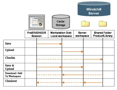

One thing I noticed is that the "update" function in Creo (via right-click on the model in the tree) - it will restore the model to the uploaded (server-side version), but as soon as it is saved to my local workspace, the update function no longer does anything.  And then using the Add function - well that brings in the last checked-in content from the common-space.
This graphic I found is quite out of date, then:
