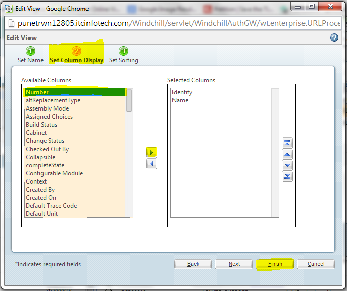

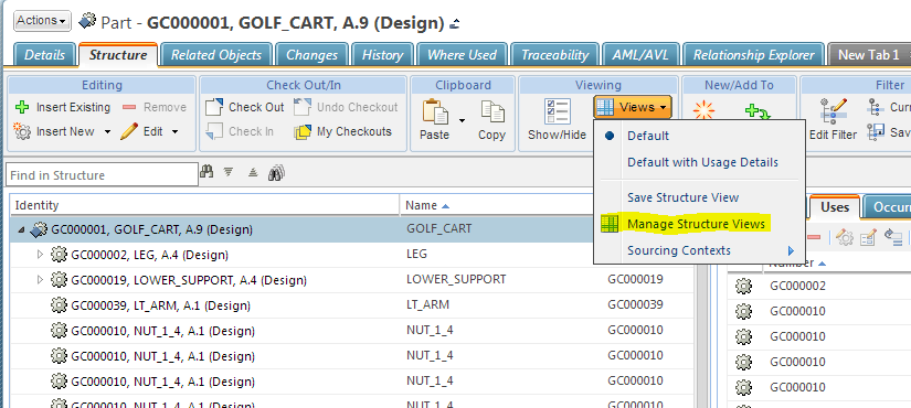

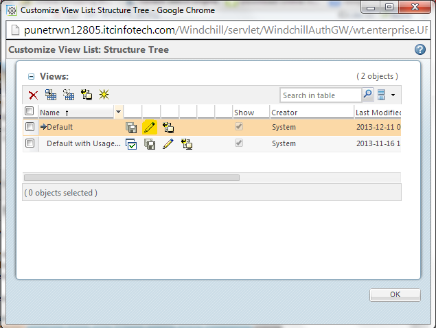

Go to Views --> Manage Structure Views
click on edit --> Set Column Display. Move the necessary columns from Left and side to Right hand side and click on Finish.
