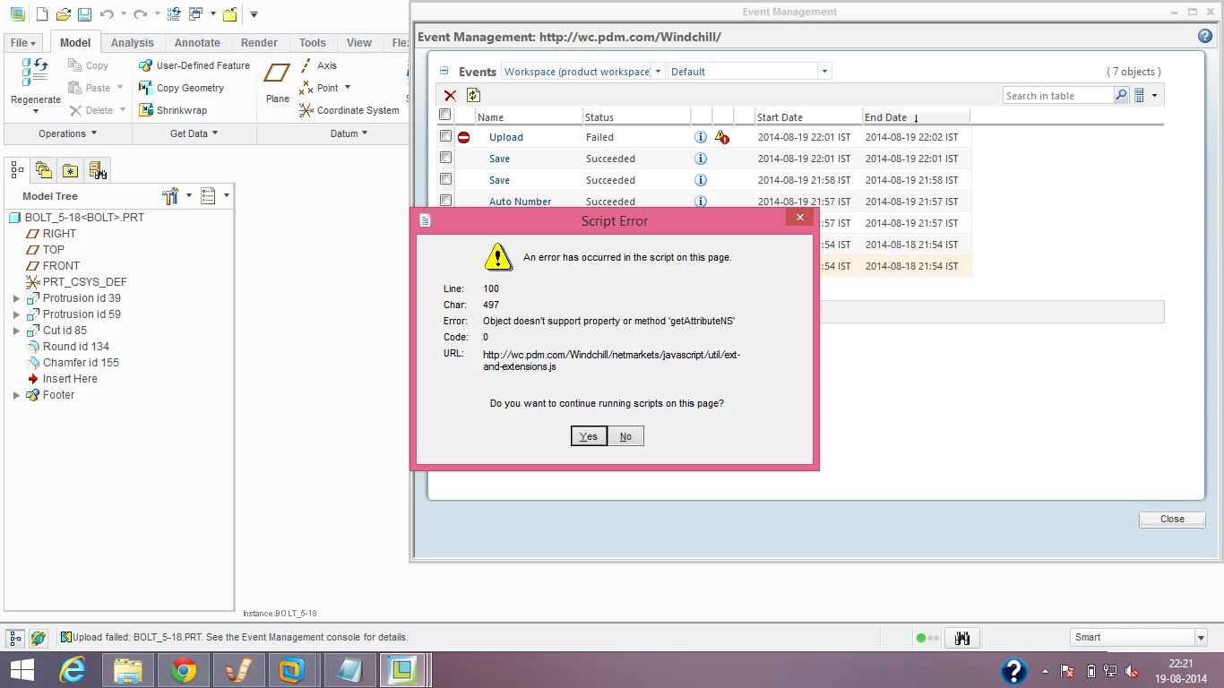

How to sort the script error issue ?
  • August 19, 2014
  • 1409 views
August 19, 2014
What browser version and Windchill version are you using?
August 21, 2014
Windchill 10.0
Internet Explorer and connected with creo 2.0
August 28, 2014
Which version of Internet Explorer are you using? This error can occur if you are using an unsupported version of IE. Windchill 10.0 supports IE 7 and 8, as well as IE 9 in 10.0 M020 and later.
