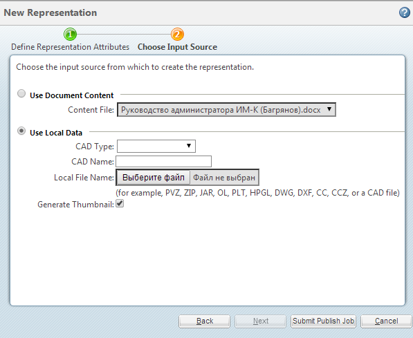

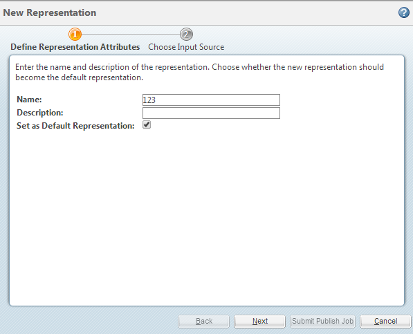

Hi! Try this.
Go to to the representations snd annotations tab of the cad document info page. In the representations and annotations table you may create new default representation like follow:
In the second step chhose your tiff file and submit publish job.
