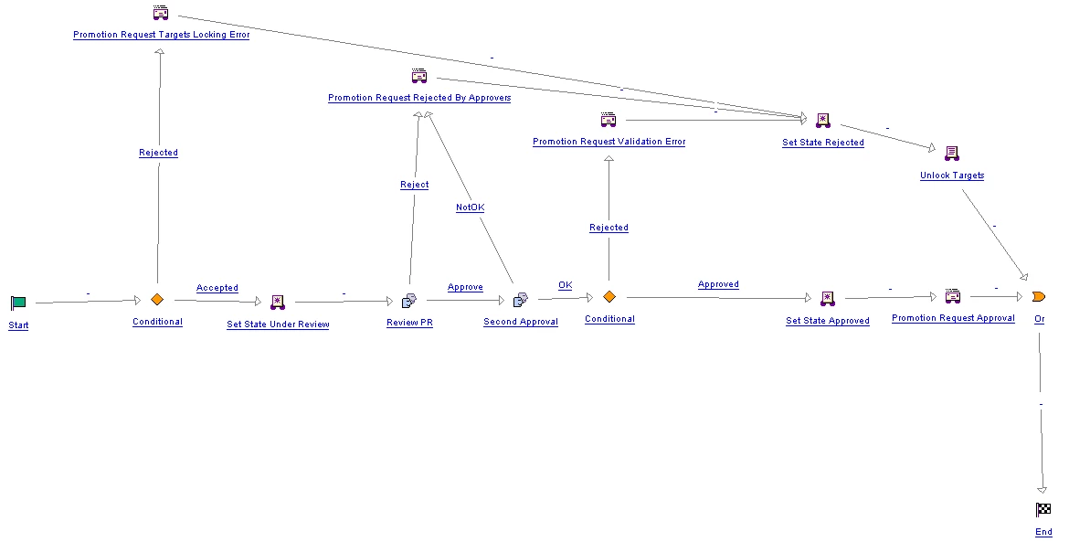

i wanted to send the number/name of the Part in the Header of the Review PR Task Mail during the Promotion Notice (Workflow).
For that i created the Variables PR_Description, Part_Number, Part_Name in the Workflow Properties/Variables and added the following code to the first conditional.
wt.maturity.PromotionNotice pn = (wt.maturity.PromotionNotice)primaryBusinessObject;
wt.part.WTPart prt = (wt.part.WTPart)primaryBusinessObject;
PR_Description = ext.testpackage.Promotionhelper.get_pn_desc(pn);
Part_Number = ext.testpackage.Promotionhelper.get_part_number(prt);
Part_Name = ext.testpackage.Promotionhelper.get_part_name(prt);

Do you have any clue how i can get the PartName and PartNumber for the Object in Promotion Notice?
Best answer by JørnAHansen
Daniel,
The clue to what's wrong is actually in the error thrown: "java.lang.ClassCastException: wt.maturity.PromotionNotice cannot be cast to wt.part.WTPart" which is due to wt.part.WTPart prt = (wt.part.WTPart)primaryBusinessObject;. In a Promotion Notice workflow the primaryBusinessObject is a PromotionNotice object. You can not just cast that to a WTPart. Luckily there is a helper method which given your pn object can query for the object(s) the user wants to promote. So replace the broken line with something like this:
