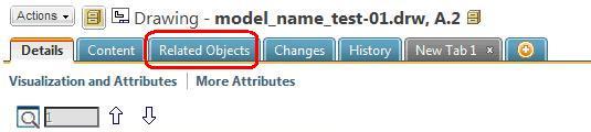

I need to find the model referenced by the dwg......
  • January 26, 2012
  • 8 replies
  • 3456 views
....in Intralink it was a snap, yet in W/C it seems a total pain if not impossible. There was a graph feature in Intralink that was awesome, gone in W/C.
so, any ideas?

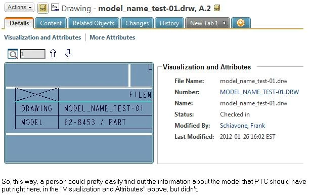

Patriot_1776
January 26, 2012
I looked for over an hour, and, after poking myself in the eyes with a sharp stick, found NADA, though now I need to resharpen my stick.
So, what I'm going to try and do, is convince management to let me change the corporate format to add the dwg name and version, and model name and version to it. This way when we do a search in W/C, we can see what the dwg's model is easily. See JPEG with comment.

Hi Frank Sir
I have not worked in intralink; so I dont know the opions
But in windchill you can check the referenced model through Related Object tab
Can you clarify the exact problem you are facing which forced you to change the format

Patriot_1776
January 27, 2012
That works "ok" (should still be a LOT easier).....only if the dwg references a single part. If you have a large assembly, EVERYTHING comes up, and you have to try and dig thru it. I looked in the book i had, nothing, and then wasted over an hour searching thru W/C trying to find some button buried somewhere that would tell me this info quickly. NADA.
Adding that info to the title block is the only way I can think of to easily get that information.

Patriot_1776
January 27, 2012
Hey James, thanks! Yep, it seems to work. Tedius, and buried under far too many screens, but there's no easy way in W/C. I'm still going to make that modification to the dwg format for that, and other reasons (linking model version to dwg version), but I've definately changed it in my views, and encourage the users to do the same.
