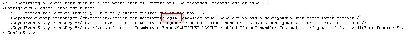

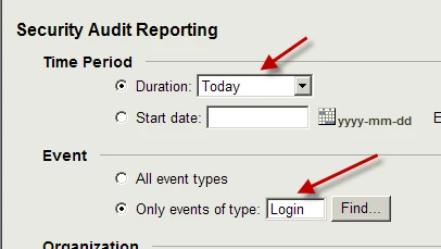

Has anyone created a report or some other way to identify all users who haven't logged into Windchill within a certain period of time?
22-Sapphire I
January 9, 2012
OTB, configAudit.xml records (only): Login, Logout (timeout), and Context Login.
Results stored in AUDITRECORD table - can be directly accessed, or via Site, Auditing, or via a query builder report.
