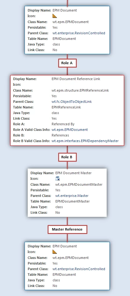

I’m looking for a little help to refine a report, made using report builder tool. (see attached)
I have report which shows non-structural references between CAD Docs, for example the model used by a drawing. This uses the EPM Document Reference Link object.
As this link is version to master, from a given version of the drawing I retrieve all versions of the referenced model. To get a single version of the model it is necessary to apply a config spec.
To achieve the result of “latest” is relatively simple, but I’m actually looking show in the report the “as stored” version of the model.
Is this possible in report builder?
Regards
