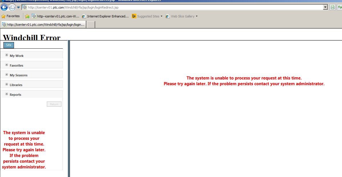

HI
When I import Windchill db to My System. Then login failed.Like this picture
Method log file (Detail see Attachment):
2014-11-06 03:16:00,205 INFO [ajp-bio-8010-exec-1] wt.system.out - Can't load ESAPI properties from classpath, trying FileIO
2014-11-06 03:16:00,205 INFO [ajp-bio-8010-exec-1] wt.system.out - The LOG-LEVEL property in the ESAPI properties file is not defined.
2014-11-06 03:16:01,125 INFO [ajp-bio-8010-exec-1] wt.system.out wcadmin - WARNING!!!!!!!!!!!!!!!!!!!!: FLEXCONTAINER IS MISSING or PROPERTIES ARE NOT PROPERLY CONFIGURED.
2014-11-06 03:16:01,125 INFO [ajp-bio-8010-exec-1] wt.system.out wcadmin - (wt.inf.container.containerResource/13) wt.inf.container.ContainerPathException: Unable to find context for path: "/wt.inf.container.OrgContainer=PTC/wt.inf.library.WTLibrary=RFA".

Thanks for any help!!
November 7, 2014
When I use Java code to print log,Found that program will running this sql:
SELECT idA2A2,classnameA2A2,idA2A2
FROM wt.inf.container.OrgContainer A0,wt.inf.library.WTLibrary A1
WHERE (A0.namecontainerInfo = 'PTC') AND (A0.idA3containerReference = 4) AND (A1.namecontainerInfo = 'RFA') AND (A1.idA3containerReference = A0.idA2A2)
joins=null
useBind=true [PTC, 4, RFA]
and result is 0 ,so report error message"
When I update the table OrgContainer and WTLibrary ,FlexPLM Working Now
