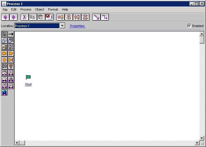

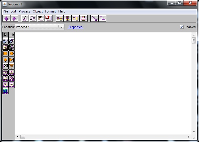

Hi All,
I am Using Windchill 10.1 with jre 7.0 Build 25.
when i open a workflow editor, i am not able to see the selected Robots in Editor area.
Normally when we create a new Workflow, it opens a Workflow editor with Start Robot.
we acn put the required Robots in to Editor area and some logic to them.
but in my case when i open a new workflow editor it opens but not showing start robot..if i try to put any robot in editor area it opens but it is not visible.
same if i try to view existing OOTB worklfows in editoe it gives me Blank editor and if i click randomley in area then the robots are opens in Pop ups but they are not visible .
i check the java versions. it is as per PTC's Recommadations.
here are two fig which howing the differeance.
This is the Actaual WF editor which normaly opens.
This is the WF Editor on My system without Start Flag.
Please suggest the solution.
Vivek
Best answer by jessh
I woudln't even bother messing with Java permissions unless the Java console indicates a security exception.
Moreover, one shouldn't have to mess with Java permissions except as a temporary workaround. If messing with permissions solves the issue, then that's an indication that something should have been fixed -- and probably that you're lacking the latest generic patch for such issues. [As Java Plug-In security updates come out, code sometimes needs to be adjusted to work around behavioral changes made by these updates in the name of security.]
I cannot reproduce your issue, but I suspect it has as much chance of being a compatibility issue between Java and your video driver as anything else. You can try disabling the Java Plug-In's attempts to use video acceleration by adding "-Dsun.java2d.noddraw=true" to the JVM options via the Java Plug-In's control panel. See http://docs.oracle.com/javase/7/docs/webnotes/tsg/TSG-Desktop/html/java2d.html for more information.
