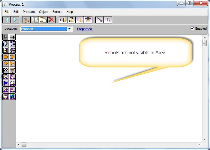

In Windchill 10.1M040,
when i opens a Workflow editor window, in editor window shows blank.
when i put robots in it , it not visible, but when randomly click on screen, it opens respective pop up window.
Please see, below image.
How to fix this ?

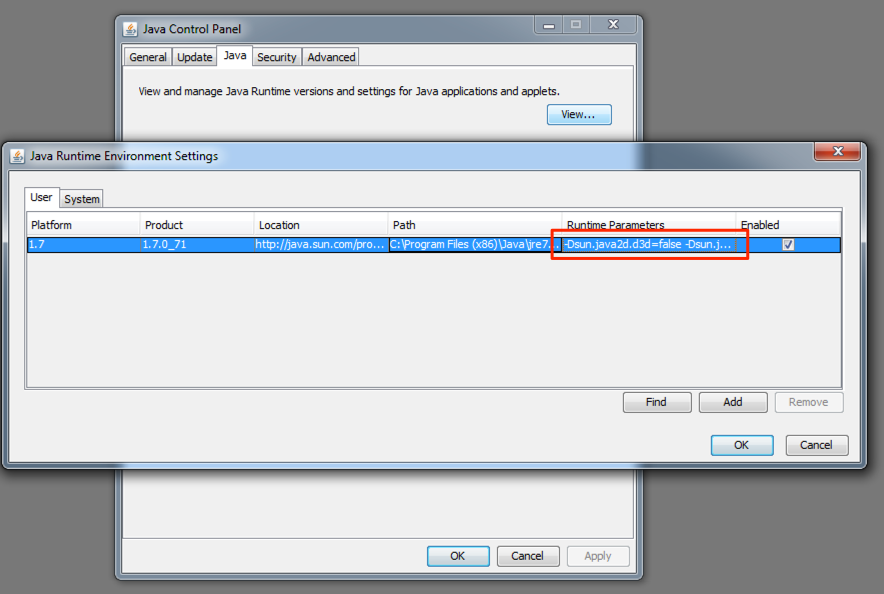

This has probably something to do with your graphic card driver.
Try to set these parameters in your java settings:
-Dsun.java2d.d3d=false -Dsun.java2d.noddraw=true
Go to Java Plug-in > Java Control Panel > Java > Java Runtime Environment > User

Hello Björn Rüegg,
Thanks for yoyr reply.
I tried the suggested settings, but no luck.
Still it opens a blank editor window.
