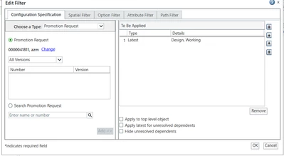

 @Fadel - I have noticed that the "Latest" filter is only applied when I view the structure of the latest version of a WTPart. When I look at the structure of a historic version, that was created on a different date to that of the latest version, the "As Matured" filter is applied to the historic structure. If I look at the historic version of a WTPart that was created on the same date as the latest version, the "Latest" filter is applied.
The issue with the behavior I have observed is that, if I release "Part 1" and then "Assembly 1" multiple times during the same day, the version history for "Assembly 1" will not keep an audit trail that communicates that it made use of different revisions of "Part 1" each time it was released on this day. If I wish to capture the configuration of a part structure each time the part is released, I should ensure a baseline is captured as part of the business process used to "Release" WTParts. Is my understanding correct?
I am intrigued by the comment from @HelesicPetr  - "Promotion Request can store this information because the PR is also baseline". My understanding is that I will have to rely on users taking baselines at the correct time to capture the exact configuration of each part structure when they are set to "Released". It's likely that users will not do this every time if I cannot enforce it via the configuration in Windchill. I could ensure that users have to raise a promotion request as part of the "Release" process. Would the process of raising/completing a PR automate the process of capturing of a baseline?

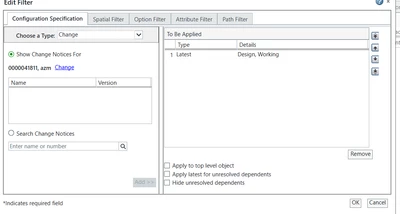

Yes , the best way to keep track is use baselines whenever you release a version.
if you are using change notices to release or promotion you can filter by CN or PR
