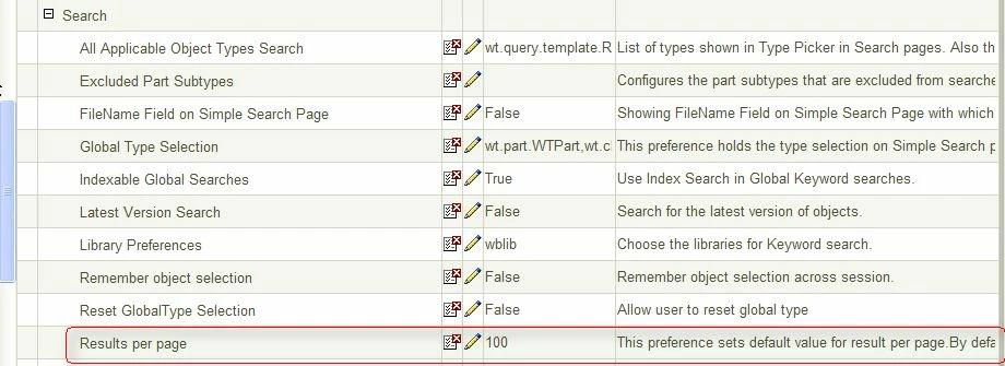

March 24, 2010
If you are referring to the value for result per page, then there is a preference under the preference manager that you can set to increase the result per page for you search operations.

March 24, 2010
Hi Alexius,
What I am trying to do is understand if there is a preference for the scrolling itself. Since the Ajax tables now in 9.1 do not display all results at once but rather populate results as you scroll, we have users that want to see more results populated.
I am not sure if this is possible. Thanks for any help you can provide.
